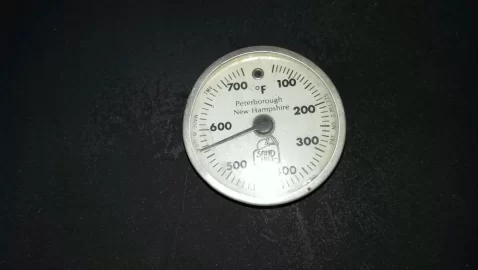

I have the original, glass covered SandHill thermometer that came with our VC Resolute I stove. Although I've read that it should get more inaccurate with age, so far it is doing great. I have verified this with an IR thermometer. This is after being on 5 different stoves since 19080 and occasionally pushed well past it's range. ;em. I don't know what they did, but I really like this old thermometer. It is accurate, durable, easy to read and simply attractive. Too bad they stopped making them.
