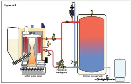

In my opinion, thermal storage makes everything less complicated.
Maybe a little bit more money upfront, but operation of the wood boiler will be much more efficient.
http://www.caleffi.com/sites/default/files/coll_attach_file/idronics_17_na.pdf

Is there and emergency gravity loop? I don't see it. Is that recommended?
The Expansion tank? I think this is a bladder tank but is there other ways?
