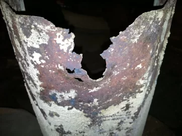

Hey need some input my ceramics and secondary chamber are almost shot after a year and a half the secondary chamber has a u shaped section gone and what's left is brittle I have a testo 330 combustion analyzer but need the specs of what I should be reading my thoughts are that their is not enough secondary air so the flame is too hot my stack really gose above 200 unless it needs to be cleaned witch i do at least twice a week at this rate the chamber will be shot by February

For an over all efficiency of 81% I'll post some pics of the trough tomorrow

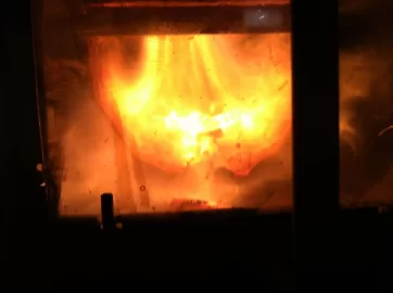

You can see how much it melted during the burn that thing glows orange
Wow that thing is wore out! I would see if that could be covered under warranty and if not I would ask the dealer for advice on how to prevent it. (I assume your dealer is smokelessheat.com)
