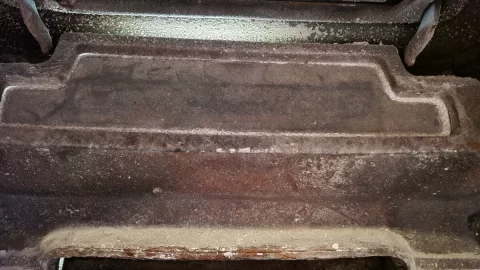

My problem now is that the stove will run hot (600-650 griddle temp) even with everything closed. the damper didn't seal tightly but I've almost fixed that. In the process I found there is a gap above the upper fireback/ damper assembly. Is this normal? Did something break loose? Do I need a new refractory assembly.

The gap is there the upper fireback just above the damper meets the top of the stove.
Is it possible there is supposed to be cement in there and I vacuumed it out (old and dry?) I haven't seen any indication that there shouldn't be a fiberglass gasket there.

Stove's got a fire in it right now so it's hard to see. I opened the doors and looked up there and I'm not sure what you mean. The fireback has the damper opening in it and above that I can see where the top mounts and there is cement up there. I've never pulled mine but I think the fireback has a gasket on it.

This is looking inside from the front doors. The white at the top is from a flashlight inside the flue collar.
The manual shows a gasket on the sides but not the top.

Ok, so I've been looking closer and it looks like my lower fireback is definitely warped. It bows in to where the catalyst is. My bottom grate is also warped. I never knew it was supposed to be flat.
Looks like I'll be buying some parts.
