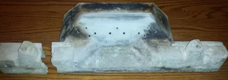

For a long time now I have been wanting to own a wood stove and enjoy the benefits of low cost heat. Well last spring we finally purchased our home and just yesterday I bought a used stove off of my neighbor. While I was reluctant to purchase this used stove I will take my chances and assume all the risk. The stove is a Vermont Castings, Defiant Non-Catalyst Model 1610 in black. I have done the disassemble and inspection process and find one problem (to date) with the Shoe Refractory. The left end of it has cracked off (see attached picture). As the part is $200 bucks, I was wondering if a Refractory Cement (such as Rutland 610) could be used to cement it together?
The prior owner was complaining of having to leave the ash pan door open in order to keep the fire burning. Would this cracked shoe refractory be the culprit of this problem?
Also, since he had this in his garage there is some light surface rust. What will be the best way to remove it without scratching the surface to prepare it for new paint?

As a temp. fix you can pin it an glue it together, it might last until the end of the season (or may not).
How is the rest of the refractory box? Have you taken the whole thing out? Chances are there is more damage inside the box.
Is this a flat black color? If so, you can use steel wool to remove the rust and repainted it using proper stove paint. Make sure to use a well ventilated space and a mask.

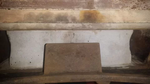

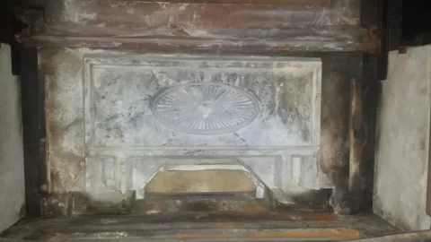

The Fireback looks okay but I have not yet been able to figure out how to remove it so I can see behind it into the Fountain Assembly.

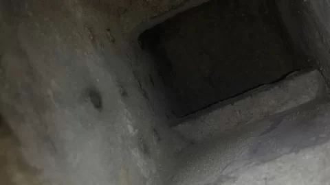

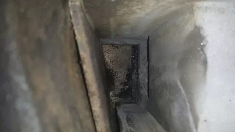

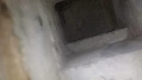

You got me thinking, so I took my camera and took a picture up inside the Fountain Assembly and around the backside of it. After reviewing the photo's I noticed a whole on each side of the Fountain Assembly from the back of the stove where the chimney attaches. These tall chambered cavities were filled with ash when I took the Flue Collar off. I vacuumed this out. But I now know that this chamber is where the hot gases travel to go up the chimney when the Damper is closed. This could have been causing the prior owners issue with a lack of air coming in due to poor draft when he closed the damper. Please review the pictures and let me know your thoughts.

Your fountain assembly looks to be in relatively good condition. Treat it like a newborn infant as it is very delicate. and doesn't have a reputation of lasting more than a few years. I got 6 out of mine but by the time I discovered it was cooked, the rear casting was also cracked from over-firing. Keep those two chambers clean or you might be hearing a CO2 alarm going off at a very inconvenient time in the middle of winter. Clean once a year and you'll be okay.

First, I want to thank you for all the advice and good ideas. I have completed the repair job on the shoe refractory and I am surprised on how strong the repair is. Very solid feeling but We will see how well it works when I put heat to it.
