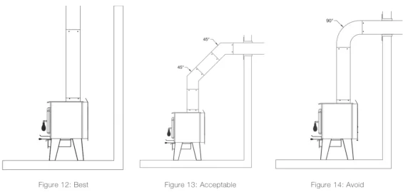

Another question I have is about the horizontal chimney run. Is 4’ too much? Basically I wanted to clear the eve of the house without notching it or using 45 degree pieces.
It goes 4’ vertical, 4’ horizontal, and then 21’ vertical.
I don’t have any issue getting a good draft, but I worry about creosote build up in the horizontal run.
Yes, that can end up being a real problem. Note that 45º chimney elbows are not permitted in the US and many chimney companies do not allow any chimney offsets to be used in exterior applications. How deep is the eave? If it's 2' or more the chimney can pass through it without notching.
If you can avoid a 90 on the interior and use 45s to create an offset, that is better too.

I was mistaken on the angle of the chimney. The kit I was looking at was either a 15 or 30 elbow kit for the Duravent chimney I used.
I’ll have to measure it to be sure, but I’m pretty sure the overhang is 18”. The chimney is on the gable end of the house.
I hadn’t thought about using 45 degree pipe on the inside stove pipe. That’s a good idea.
