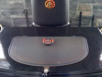

A straight up 8" double wall interior, about 21 feet total.
See photo of the setup and thermometers. The griddle sweet spot is 575F and 275F on the flue.

Very nice, it's so clean it almost looks unused! The flue collar seal....is that just light shining on it? What flue temps do you get in the early stages of the burn?
The wife dusts the Black gloss enamel finish. ;>) The glare is just the sun, when the photo was taken early last fall. Before it started to snow... and snow.
At cold start-up I try to get the flue temps to 150 to 200F ASAP. I like clean flues!
I am still impressed how clean it looks! What is your avg. flue temp. The reason why I am asking is because I get around 400* on avg. using outside magnetic thermo. & that is almost double what some other stoves (non-cat) different brands get.
