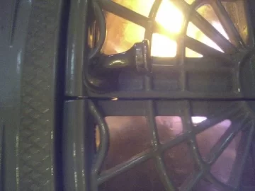

only flaw ive noticed in the stove is 2 small spots at top of door seam where i can see fire through but otherwise seems air tight
this is the small air leak i referred to it appears to be above and below the door latch

3. Replace the door gaskets so you can fix that air leak, which could be effecting how the stove burns.

I also have that slight gap at the top of the doors, unfortunately, after spending friday morning regasketing the stove, it's still somewhat there. There isn't anything to glue a gasket to there because you have to be able to swing the latch.
Not sure what to tell you. It should not have a gap.
It's much less obvious then before I regasketed, but it's still there. I don't see where you'd even get a gasket there because of the latch.
You need to wrap the gasket around the latch so the gasket loops around the entire outer area of the door.
cool thanx guys i will def pull the cat out and take a look at it. it was barely used but some crap may have jostled back there horsing the stove around getting it in the house. i kinda see where a new gasket will help the old 1 doesnt look great.
