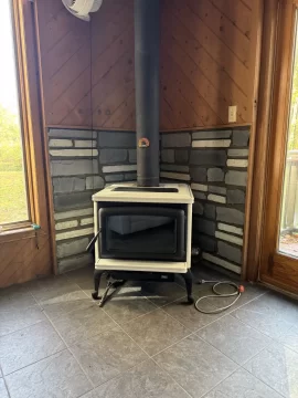

Here it is installed but before the first fire.
[Hearth.com] Upgrade to a large wood stove: Input needed
That's too pretty. let the break-in begin!
How many channels do you get on that Carp? ;):cool:
Good move, Carps! 👌 Simplest stove I'm aware of (other than an old smoke dragon,) with the fewest moving parts. I like that floating firebox idea as well. I got my SIL a T5 about 5 years ago and it's been great. One thing about the PEs...they draft like an EF3! 🌪
You may need a flue damper or two, depending on your chimney height.
Try for more channels with a DTV2BUHF and an LNA-100.
Have a Chimfex on hand, this rig has been known to cause spontaneous flames in the box. 😏
