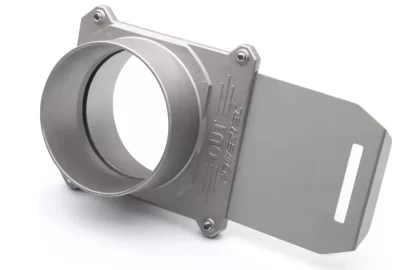

Not sure if I should be starting a new thread to ask this question that's slightly unrelated to where this began. But will stick it here and hope I might get feedback.
I had a suggestion from someone in Vermont with an older Napoleon stove to install one of these cut-off gates in the outside air intake. He claims closing it at night (before sleep) helped temps stay warmer in the room overnight, and closing it did not prevent the fire from still going well for the first half of the night. But I have a feeling that for some well-sealed stoves that 99% rely on the outside air intake, closing this would only be advisable if the stove is fully cold.
Do many of you that have exterior air intakes use anything like this?

YOu have BK and RAIS in your sigblock. Not sure for what stove you propose this.
For the BK I would not do that; this may work with a leaky stove, but your BK is not (should not be). If leaky it may suck in enough air to close this thing and have a decent burn - but using inside air, meaning the benefits of your outside air kit are not used.
Your BK is (should be) so tight that if you restrict the air coming in with something like this, you'll end up choking it too much.
Now it's not bad to have this thing installed, as long as it's open while burning. In summer when you're not burning, closing off the outside air can be a good thing.
But air inlets are generally sized to provide the air needed for the stove. Restricting that (severely) with a valve like this while burning won't be good - unless your draft is far, far too high (leading to too much air flow, that you could cut down on by *partially* closing that valve - not completely).
That's my $0.02

Definitely a bad idea. This would be a real problem on a stove with the OAK as the only source of air. The Napoleon owner's stove is likely running on secondary air only and what is admitted by the EPA bypass hole.
I would only close completely when the stove is cold. I might be tempted to use it as a damper but that would take some experimenting.
If I closed it I for sure would have a CO detector in the room.
