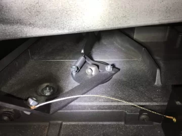

- The damper manifold also gets air from the the sides. See where the white zip tie is sticking out:
[Hearth.com] VC Merrimack air intake?

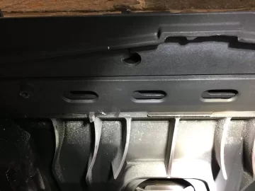

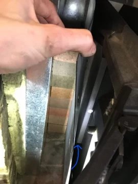

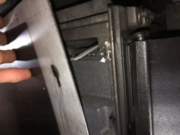

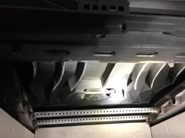

Few more pictures I took while it was partly apart:
[Hearth.com] VC Merrimack air intake? [Hearth.com] VC Merrimack air intake? [Hearth.com] VC Merrimack air intake?
