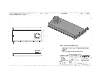

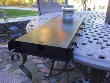

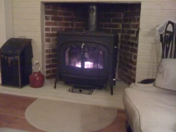

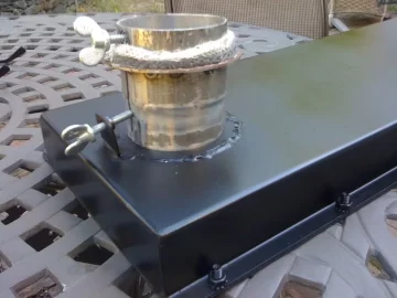

The intake pipe I used was from Napa (part #28242) measuring 3 1/8" OD. There are 2 rope gaskets used onto of the flange to seal against the stove (has a taper to it). A 1/4-20 nut was tacked inside the pipe and the wing nuts holds it in place. The second wing nut is used to apply pressure against the pipe to keep the box from rotating/moving from side to side. But do to the weight of the box and the slight pressure form the stove heat shield resting on top, it is not needed. This idea came about when a Vermont Castings tech made the trip down last year to resolve the run away problem with their own reducer they fabricated. It was a plate measuring 3 1/8" across with a 1" hole cut out in the middle. Problem with that was, you couldn't ge the stove going unless you cracked the ash pan door to allow more air in. Hence the adjustable air intake. So it been working out great for me. I can keep the stove longer in the sweet spot-300* for a stack temp and 600-700* for the griddle. In fact, VC should offer something like this for high draft/long chimney runs. Problem solved.
Stay warm
Wes
