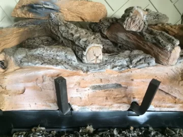

Ran across this issue at a customers home on a vent free insert. Has anyone come across this before. The unit has been installed and burning about a year. No salt water and it is not being touched by flames.

Just throwing this out, since I haven't done a LOT of servicing on the room-vented appliances, but my thinking says those whitish deposits are the byproducts of something that was in the combustion air as it burned in the open flame. Whether it was an aerosol spray, dog hair or some other compound, who knows?

Daksy Thanks... My first thought was salt water condensation. So you have confirmed my idea of a residue from the air. BTW I was hoping you'd see this post as I respect and trust your knowledge. Thanks again

The white deposits from a VF appliance are typically silicates. Generally from dusty or other particulates in the household air.
I agree. The odd thing was these happened overnight to a unit that has been installed for years. It was cleaned and re-lit. The issue has yet to happen again. Thanks for looking and helping. Love this site.
