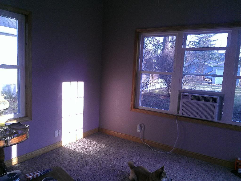

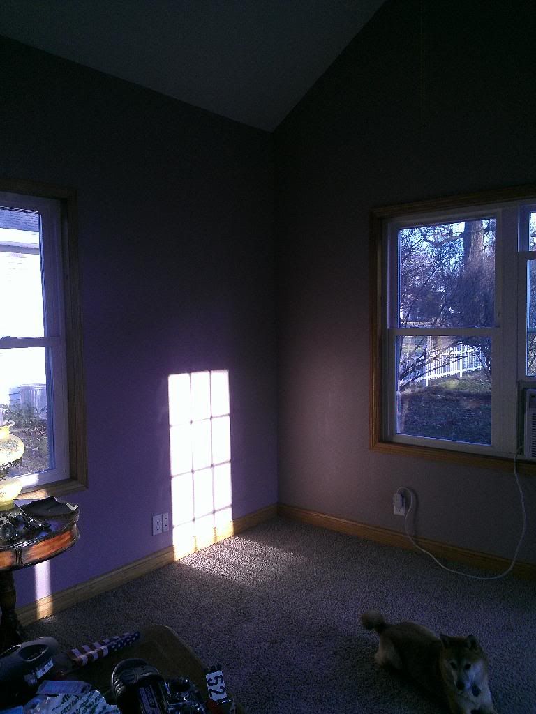

Alright, this is currently my three season room. It is fully insulated with reasonably efficient windows in it, it simply doesn't have any heater ducts for whatever reason. The plan is to cut the corner out of the carpet, build a hearth with a cement board base and ceramic tile over it. I'd like to run the chimney out of the wall to the left in the pictures which is an east facing wall. I'm planning on using the rise that the simpson kit comes with to avoid the sooty snow that I have seen with other installations simply for looks and to prevent the dog from coming in covered in soot everyday.

Also, check the installation instructions on how close you can get that exhaust to the window. You might need to keep it very close to the corner.
I emailed amfm first and they responded almost immediately. They told me to have Englander take care of it. I never got through on the phone with Englander and it took almost two days to receive an email back but they did say that they would take care of it. I'm becoming more concerned with the vent placement in conjunction with the windows as well I'm wondering if it would be better without a rise or if I should just hug the outside of the corner.
