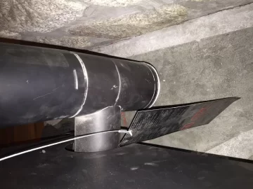

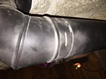

i had a pellet stove installed 2 years ago a hearthstone heritage 8091 needs a new appliance tee 3 to 4 inch but can't tell what brand
Post us a couple good clear pictures. Can usually tell by the way companies crimp the pipe lock.

[Hearth.com] Vent pipe brand
Looks like Duravent. Lot of it used as its the cheapest. Often called duraleak as its elbows and joints usually leak and a good amount of silicone is used to seal things up. Use of antiseize on the pipe and silicone self bonding tape on the outside makes the pipe useable. I have not seen the tee and cap like that.
