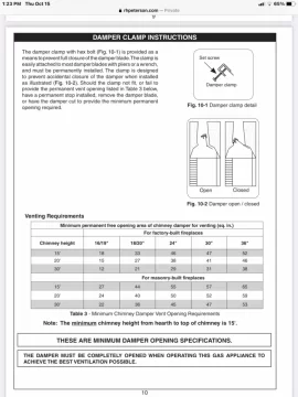

I have encountered this issue in the past. people usually have the damper all the way open. it’s like a open window blowing down the chimney .I try to set the damper clamp so that when it’s closed it’s just a little over the minimum. Like 10%. -20%. That way they don’t have to worry about opening and closing it. .Some people just remove move after it’s installed and then complain that the pilot keeps blowing out when they use because the damper is wide open.

From what Ive been told in Massachusetts the damper has to be removed.
