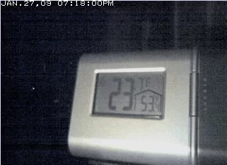

Vent free may be OK for some folks for attended use. But if you intend to use it as a backup for not allowing the pipes to freeze (when you are not there) AND/OR if you intend to use very heavily, I would caution against it. Lots of downsides, including the fact that once it gets a bit out of "tune" it can deposit soot and film on walls, windows, ceilings, etc.
Also is an "open" fire, which means you really should be close by when using it. As mentioned, I'm even afraid of some units with big glass windows!
I also put two electric heaters (oil filled) in my second home and set them on the special setting (42) which is made for keeping pipes from freezing. So now I have a few backups and also can remotely monitor the temps with a web cam.....my patch job for this was a indoor-outdoor thermometer and wireless web cam.....
Oh, and a night light...see enclosed.
  • [Hearth.com] Ventless or vented?  Stove suggestion?

YOu are very clever with your webcam and all. I think if we had a land line phone at our second home (Cell phone is great there) then we may consider a set up like yours even to turn the heat on before we get there.
At this point since our second home is in a very cold area we feel we need to set a few things up just in case the power goes out for days and we can't get there. At least then we have the peace of mind that all should be well.
