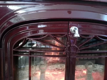

Yes. I can see the flame through the slot in the back and there is no smoke at all coming out of the chimney.

Here is a pic. You can see the horizontal slit in the back with secondary burn and no cat.
