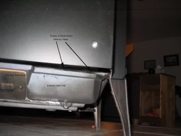

Downeast... I double checked again and I think we are talking about the wrong Left Rear location. From the Owners Manual, I am looking where the Back (item 6) meets the Bottom (Item 44)... not where the Ashdrop (item 53) meets the bottom (item 44). From what I can tell, the Back sits ON the bottom.
Another way to look at this is to find item 42, the Primary Air Frame. Just above the top of the Primary Air Frame you will see a straight (jogs a bit in the middle along the form of the primary air intake), uninterupted seam that runs the entire length of the back of stove. When viewing from the back, on my left side I can see an ooze of cement just inside the seam and on the right there is nothing. For about 3 inches from the right corner toward the Primary Air Frame, if I hold a match to the seam, the flame is drawn into the stove.
Once again, thank you for your assistance. Time for a photo I think.
Another way to look at this is to find item 42, the Primary Air Frame. Just above the top of the Primary Air Frame you will see a straight (jogs a bit in the middle along the form of the primary air intake), uninterupted seam that runs the entire length of the back of stove. When viewing from the back, on my left side I can see an ooze of cement just inside the seam and on the right there is nothing. For about 3 inches from the right corner toward the Primary Air Frame, if I hold a match to the seam, the flame is drawn into the stove.Once again, thank you for your assistance. Time for a photo I think.AGE
Thinks we got a problem of communication. Photo did it: what kind of digicam did it ? Just last week we gave up our waterproof film camera; too many Luddite name -calling among our friends outdoors. I will check our Encore again tonight.
Craig had a good point about being "gun-shy" after one problem with a stove. Possible ? Furnace cement may do it. It comes in a tube for a chaulking gun to pressure it into that crack---good try. BUT:
That seam looks like poor ass'y. Since the stove is under warranty, push for a solution with a time limit. Go to the top as we agree, to decision makers, not their employees. I was extremely annoyed in 2000, with CFM as well as their dealer ( former VC exec ! )who promised me personally that he would check the stove before delivery. Since the stove was for real time heating, I had an independent stove installer/rebuilder do the repairs without waiting for the zone manager to "look at it" when he was "in the area", then got the cost refunded from the companies.
I am surprised that a few stove buyers posting here accept poor workmanship and QC that would be completely unacceptable in any appliance ( e.g washing machines, refrigerators.....) costing less than 1/2 as much as the average name wood stove.
First off, I am a Canon man. Have a few SLRs and now a couple of Canon Digitals. The appending text and arrows are with Photoshop Elements. The cool thing about the Canon "A" Series point and shoots is that have an available waterproof casing for about up to 120+ feet. It goes for about $140. So, you can be a "Modern Luddite." Don't need anything more powerful than Elements. It does the trick nicely... Now back to our regularly scheduled problems...
Yesterday morning I injected a bit of gasket cement into the crevice just to see how she behaves. Last night started a fire and just kept it easy. Again, not behaving as anticipated. Very little control. This morning I woke to 11 below and knowing I am going to be here all day I went for broke.
First, it heated a lot more quickly than usual. With just my kindling start, my newest thermometer had me at almost 400. Added a couple of smaller splits and turned it down to 1/2. It got to 600 and I closed down the primary completely. There it hung with a slowly dancing flame. Again, normally this would douse the flames almost immediately and the stove would cool. When that got to good coals and the stove started to cool, I put in two decent sized splits (it can hold easy eight to 10) and engaged the damper. The addition of fuel cooled the stove down effectively and it sat at about 450... and then she started to move... With two splits, the damper engaged, and primary air closed, she moved back over 700.
So, yes I was gun-shy but I have learned this stove so perfectly that I knew things were not right. I couldn't imagine what would happen with more fuel in it.
