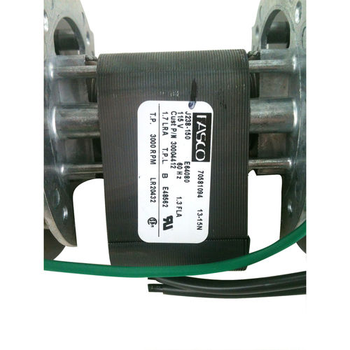

I need to replace the blower on my Vermont Castings Montpelier fireplace. I've seen them cost close to $300. Does anyone know of any cheaper options? Thanks.
Just installed the EPA certified Montpelier II wood insert. I priced out the blower online and you’re right, they are pricy. I suppose a specialized blower will be.
This is an old thread, but I will leave this info for Montpelier owners in the future.
You could try here, but note the 5 week lead time.
It looks like a common Fasco A133 blower, with side tabs for mounting. If so it would be worth checking measurements and see if a stock Fasco could be ordered and the tabs attached to it.
