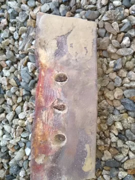

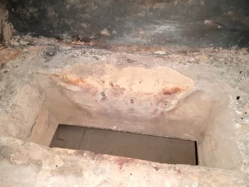

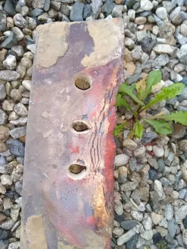

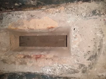

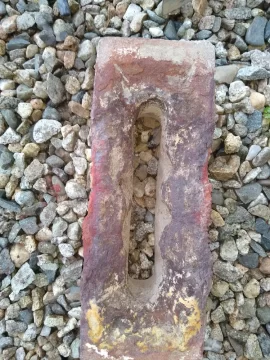

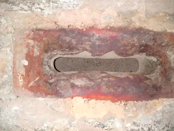

I have not attempted to cast one yet since I was hoping to buy one from Mark at AHONA. Unfortunately, he doesn't respond to numerous calls and emails. That was my concern purchasing the Vigas was dealer support. That concern has materialized. I since removed the cast iron nozzle and it is worse than I thought. In addition, the casting in the firebox is crumbling pretty bad. It looks like I will have to begin the process of casting in place since the dealer is of no service. Any thoughts on casting this in one piece or do you foresee a problem as one piece?

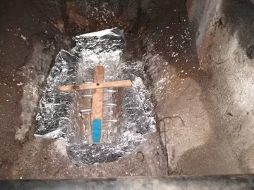

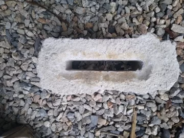

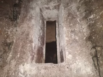

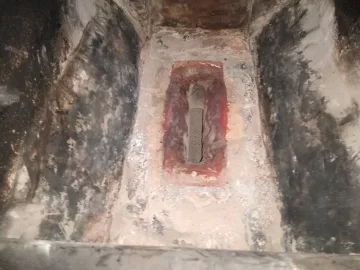

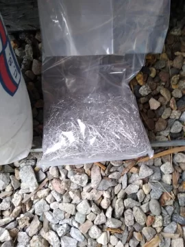

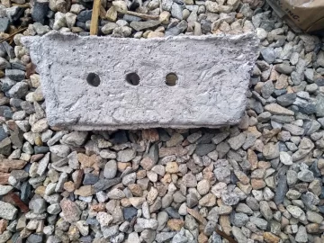

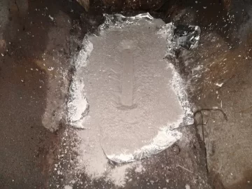

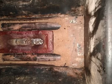

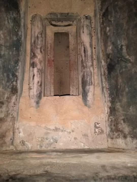

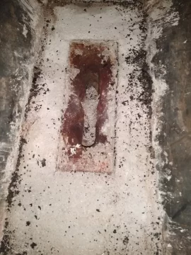

The dealer finally got back to me, However, I was already in the process of casting my own. It turned out well. I used a castable from Sheffield in Massachusetts with a 3000f rating. I added 2 lbs of 304 stainless needles for strength. I hope this makes it indestructible. One 50 lb bag was enough for the nozzle, a new bed and two firebricks at the pan below the nozzle. The material used in the original nozzle is only rated for 1400f according to Vigas. This seems quite low. I will post pics in order. The first is the base all chopped out. The second is that I used the old cast iron nozzle as a form. I covered it in grease, but it still was a challenge to remove. The rest of the pics should be self-explanatory. At the end I burned out the wood and the pvc tubing. The nozzle edges are rough but it does not matter. I should be able to buy a factory nozzle and have it drop right in if needed.

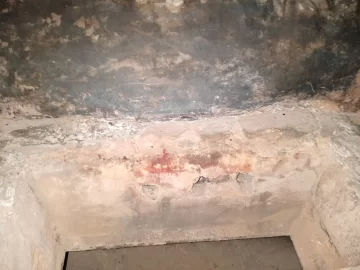

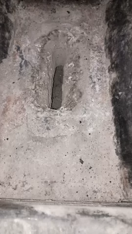

Here we are again. Three seasons and the cast in place nozzle is worn. I expected longer life but I believe the issue is proper curing. The product has a very specific curing process which is impossible to do properly in the in boiler. This definitely caused it's short lifespan. I guess it's back to buying a factory nozzle. Now the trick is to get AHONA to actually get back to me. Multiple emails and voicemails with nothing returned. They must be out of business.

Could you get a machine shop to make you one out of stainless steel ?
Probably but it's quite complex. I would imagine the cost would be astronomical. I contacted Vigas in Europe. They got back to me within 24 hrs and contacted AHONA for me. Ahona is shipping me a new nozzle.
Just FYI, I know some brands use stainless steel to fabricate their nozzles...1/4" thick material...maybe a bit more? Seems to work fine though.
Also, some people use firebrick on top of their nozzle, to act as a sacrificial surface.
