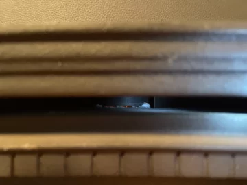

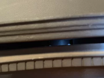

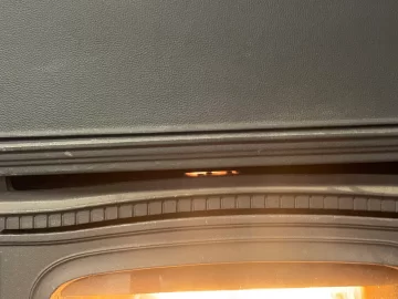

This brings me to my post, which was concerning me this morning. Lately I’ve been cranking the fire with the door wide open in order to get the fire going. After getting sufficiently hot, I close the door and regulate the fire with the air intake. This morning after a couple weeks, I start the fire as normal and close the door. When regulating the air, I hear a loud rumbling noise when air intake is turned to low. I also noticed for the very first time what I would describe as visible fire in between the firebox viewing area and the flue (where the fan blows out the hot air) - see attached.
After 10-15 minutes, the problem subsided and I no longer hear the rumbling noise. But now I notice there’s an “outside” flame when the flame is high in the firebox.
Is this all normal or safe? Does this indicate damage to the wood stove which makes it unusable?

Is your liner connected? It almost looks like you’re seeing fire outside the stove.
You might want to have someone run a camera down your liner, you may have had a chimney fire also. Rumbling isn’t normal.
You shouldn’t need to leave the door wide open to get the fire going.
Your wood is most likely making creosol, adding to an additional problem in the stove.
Get it looked at.
Who installed this? DIY, the dealer, or someone else? If it's dealer installed, I'd be on the phone with them ASAP.

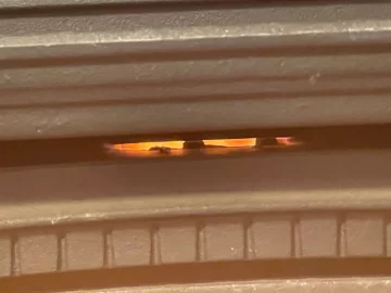

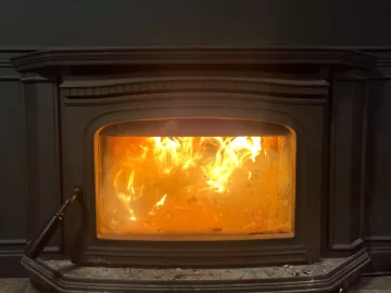

Thank you both. I think you’re right. I shined a flashlight while getting the fire going again and noticed there’s certainly a gap between the firebox and where the liner is connect - see attached.
I had a 3rd party install this unit 3 years ago. I’m not sure what my recourse is. I guess I will have to call them and get the liner reconnected to the firebox?
Is there any safety issue using the wood stove in the meantime?
Much appreciative of your feedback.

I wouldn’t use it! You have a hole that could let combustion byproducts into your home.
I think you’ll want to get your liner looked at with a camera too. That rumble may have been a chimney fire. That fire might have knocked your liner loose.
I’d call a sweep.
Don't use it....it is indeed unsafe. Your lucky nothing bad has happened.
It's a blessing you're observant.
I'd hire someone else, if your unable to do it yourself. I would not go with the original installer.
Reactions: kborndale and TSB
It looks like the flue collar is not properly secured. That gap should not be there. There is a specific procedure for bolting on the flue collar that has not been done correctly. It requires removing the baffle and tightening from the inside of the firebox. There will be no gap if the collar is installed correctly.
This needs immediate attention. The insert should not be used until this is correctly addressed.

It's unlikely that this would be related to the overfiring if that happened. The collar should have been bolted on solid. There is evidence in the picture that the installer knew something was wrong. It looks like there is some sort of sealant showing at the edge in one of the pictures. If the collar had been properly installed this would not have been needed. That's what made me wonder if the liner needed to be dropped down an additional 1/2" so that the flue collar fit snugly before securing it. Or if the flue collar is secured at all?? He may not have bolted it down and the liner pulled it up as it contracted on cooling?
