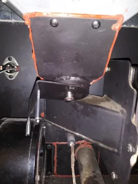

This all started after i replaced the auger shaft, which was a real groan... and was nothing like the video showed. I mean I really had to go through hell to do it... ive had the board tested and there is nothing wrong with it. I have an outside air kit and the door seems fine. The picture below is the compartment where the auger shaft is located, so when I was installing the auger shaft the old shaft would not come out like the video explained, so I figured I could just unscrew the two screws of the compartment, and remove the silicone to make it easier, but it wasn't. The compartment doesn't open. Ive never resealed it with the silicone, could that be the problem ? Because the picture I'm showing you was before I replaced the auger shaft. Thanks

If there was a vacuum leak from it not being sealed, it would be a different error and shouldn’t take a half hour to show up anyway. Well I suppose there’s the possibility it could heat up, open the uncaulked joints, and dilute the hot exhaust air with cooler room air. Whether it’s enough to fool the thermodisc I don’t know. But you could bypass the thermodisc and see if it still runs out of pellets. That would narrow it down for you. Just don’t do it unattended, the stove won’t shut off on its own.

Have you tried bypassing the thermodisc? Unplug it and connect both wire ends together. Don’t let it short against anything. That would rule out if it’s tripping due to cooler air leaking in from the uncaulked seams. Like I said don’t leave the stove unattended while doing this.
Thanks for that I'll try bypassing it and stay with it, btw do I need to put a piece of wire in-between the connectors ?
Yes just make sure the wire doesn’t touch anything else or you’ll fry the board. Hopefully it will start up without reporting an error.
Reason you don’t want to leave the stove unattended this way, is if the fire really does go out, it will keep feeding pellets until the hopper is empty. And if it keeps feeding pellets you’ll know it’s not the auger motor.
If this makes your stove run better, then I think you either have another bad thermodisc, or you need to caulk the seams where you disassembled it because it’s pulling in cool air and fooling it into thinking the fire is out.
