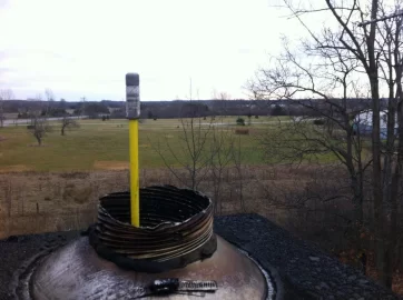

  • Went to my local hearth shop yesterday to discuss with installer a couple what I thought were minor issues I noticed with my liner installation when on roof cleaning it last week.
Issue 1- cap doesn't fit. A 5" cap has been used on a 5.5" liner. Screwed on 3 sides gap left at the back, very sloppy to say the least
Issue 2- about 5 feet down chimney there is a seam in the liner which I always thought looked a little rough. Almost like 1 piece shoved into another. Brought this up with original contractor last time I cleaned. He said " yes there's a seam nothing to worry bout"
3- and I didn't even realize this one apparently the top termination of the liner if that's what you call it is not done correctly (pic below)
After talking with him he informed me the installer I used is known as a hack throughout the industry and he's ripped out two of his install this year, both of which had mutiple small pieces of liner shoved into each other, not proper or to code. Apparently you can have seams only if you use the right coupler

One look at that and I would hate to see the rest.
That is some nasty looking work. Sad story you have there.

Is the upper fragment of the liner fitted into the bottom longer piece or did he do it the other way around?
pretty sure other way by bulge in lip
Like I said ain't pretty had more creosote there as well. Install
Was almost 2yrs ago so don't know what recourse I have
Can't you get the inspector out one more time... Or another inspector? Sorry if that a silly question.. Don't know how things work your way. could the faulty install affect your insurance, even though it was passed by an inspector? I'm wondering if that might offer a solution... If you could involve the insurance co
Even if they would deductible is cost of parts lol
The reason I ask is for the potential for creosote to run down the outside of the liner if it is done that way. That would be quite bad inside of the chimney. Fly that by a reputable installer in your area. The fix is to pull the liner up to where a proper coupler can be used to splice the liner. Then reconnect to the insert.
