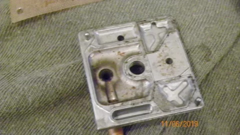

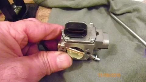

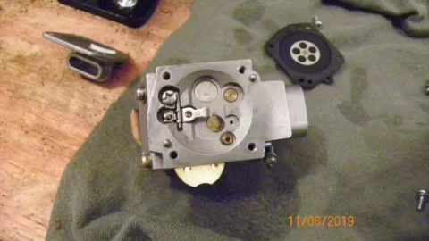

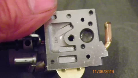

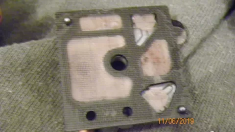

I'm just waiting on the carb kit for the old carb from the 310, I took it apart just so I could get some pictures. This will be a first for me, the old carb has some dirt on the inside so maybe that's what was causing it to run for 20 minutes and then act up.
The first four pics are from the bottom of the carb, in pic 9850 I cleaned up the edges where there was some gasket stuck to it.

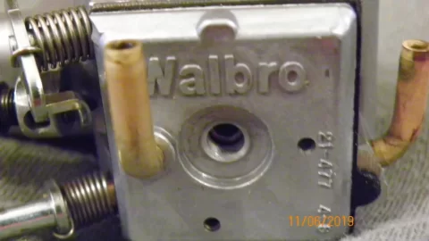

How do the two copper looking parts in the picture come out, special tools?
[Hearth.com] Walbro Carb
After plowing most of the day, I cleaned up the carb with air after its soaking in mineral spirits for two days. The carb is in the basement and I'll put it together tomorrow.
Personally, I usually don't need to dig into the carb that deep. Most of the problems I've had, have been cured with new diaphragm needle valve etc. You can pull that screen with a pick without causing trouble. Carb kit should have come with a new one. Once you get into the Welch plug etc, things can go awry according to some while others say no problem. That being the case I have had luck keeping it simple.

I have everything together but the inlet needle wont' seat, any tricks on getting that to seat?
Assume you mean the one in this pic? I've never had one not seat OK. If the old and new seem identical then could only guess something is stuck in the needle seat?

Never have had the need to pull the Welch plugs(copper things) A walbro rebuild kit is all you need most of the time. Peace
Reactions: thewoodlands
I usually re use the metering lever and spring (lever that moves the needle) the levers are bent at a specific angle set with a special tool. Usually they sit a bit below the surface of the carb body. If bent wrong needle wont open. I usually dont remove the welch plugs. If you have to just punch a hole in them with an awl and pry out. To put back in place them in hole and hit center gently with a punch. I never remove the brass jets with holes in them it ruins them.
