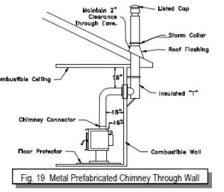

In the BK Princess manual the rear clearance increases by 5" for the stove and pipe when installed with a 90* stove pipe to a wall thimble vs. a straight up exit. Does the stove burn (that much) hotter with the 90* (I will use two 45* if there is room) instead of roof exit?

Doh. / :red: of course. Seems to be based on an assumption of single wall pipe. Which they don't recommend. It doesn't make a lot of sense when using double-wall connector.

Any chance it has to do with the horizontal section? ie - maybe the shortest pipe section they make means the stove has to be 5 more inches from the wall to fit? Or maybe they want the horizontal pipe-to-90º fitting joint to be a bit away from the wall so you can see if it's connected properly?
Hmmmm. I never thought of the distance from the wall. I think code requires the class A to be 2 or 3 inches into the room, so you might be on to somehting here Cozy.
BeGreen, right below the picture you posted from the manual, page 22: Due to the high efficiencies of these units, Blaze King recommends the use of
double wall pipe from the stove top to roof or wall exit.
I think in another place in the manual it says use single wall pipe IIRC.
I went over the installation instructions and found them a bit frustrating. There were so many exceptions that they just should have done a separate table for double wall pipe vs single wall. Not the best docs that I've read.
