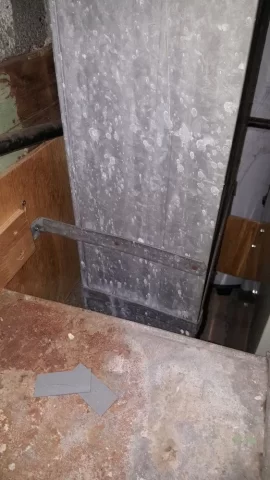

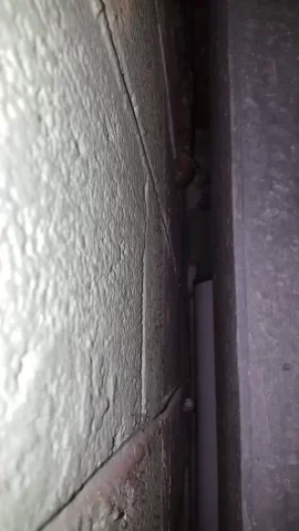

If the ductwork sections are connected with slips and drives it can be a relatively easy process. All depends on how it was put together. Take a side and front picture of the supply duct in that area and post it here.
I cant get front pics of the duct work, but here are side pics of the top and bottom where i would take it out, and the gas line behind the duct.

I say you need to take apart that duct work to remove the pipe altogether. It is allot less work and will be better in the long run than modifying the cabinet. Next week is going to be warm anyway id wait till then.
The duct work is held together with conventional slips and drives. The long faces have an S shaped slips that give the next section a slot to sit in. The ends have drives which slide over folded back lips on the ducts. The ends of the drives are folded over. If nothing else see if you can get an HVAC man or helper to work with you, maybe on a weekend. It should take about an hour or two to removed the duct, remove the pipe and cap it and re-install the removed section of duct. Be sure you turn off the gas and bleed the pressure first.

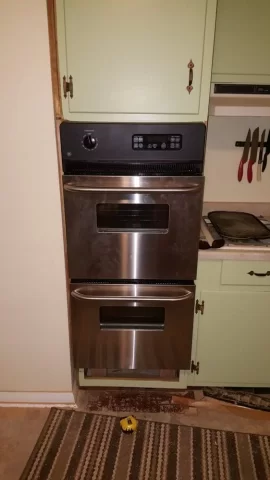

Got some clean up to do, but she is in there. The final decision was made this afternoon, and that was to move the whole cabinet out 1.25 inches. Everything clears and I just need to wire it up to the breaker box. Whew, no blood, but sweat and tears went into it for sure!

I would've removed the pipe from the side of the wall you can access
& then threaded a shorter nipple back thru with a cap already on it.
Case closed.
I thought about that, but wasn't sure how easy it would be to recheck for leaks after done.
