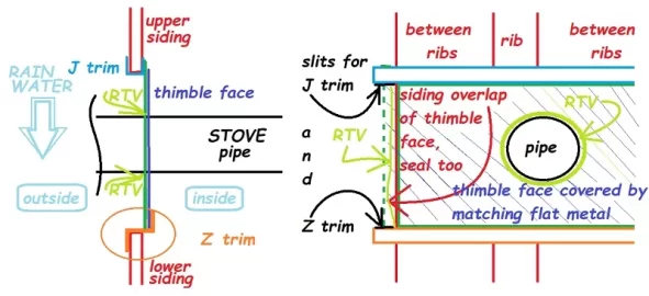

Just like you trim a window, and water runs down hill, and if me, I would cut a separate piece of flat metal square bigger than thimble and a hole in center that fits the pipe and seal it over the thimble, but under the upper siding, and "Z"ed (flanged) 3/4" deep so the lower edge is over the lower siding rib. Or you could cut this piece so the lower edge is even with the lower siding cut, and use a piece of "Z" trim that starts under the piece covering the thimble, but over top of the lower siding. Seal the sides to siding with clear or colored RTV as it ain't gonna get but so hot. Water runs down hill.
Picture is an attempt to draw my idea, section view and looking straight into pipe view. Hope it helps.

I drew the ribs vertically. They are just about 3/4" high and have angled sides and rounded to, total near 1-1/2" wide at the base, you said the pipe was going to exit in a rib's line.
Water coming off a rib from above needs to fall outside of the thimble's face, not behind it.
Water off the thimble's face needs to run onto outside of any ribs & siding below.
