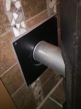

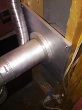

Hope these pics help.
See my install below.
A round hole was cut only large enough for the pellet pipe to go thru the cement board on finished wall.
1st pic is inside boiler room where there is no sheetrock so you can see the thimble screwed to the studs.
2nd pic is outside boiler room where the black finished thimble section is screwed in and porcelin tile is cemented around it!
