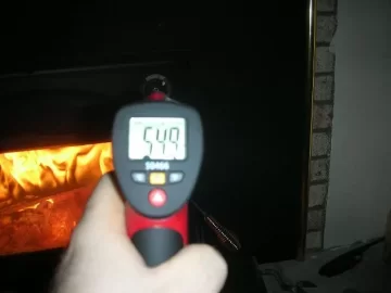

first pic is a reading of my magnet thermometer

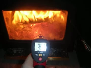

second is a reading of the fire through the glass
third is the air temp and relative humidity right infront of the blower, it was still climbing, but i couldnt home my hand there anymore

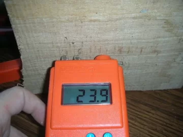

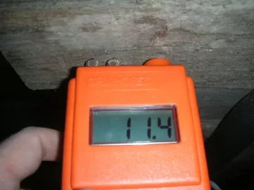

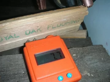

now for the moisture contents:
first is some white oak slabwood that is about 4 months old
second is scrap sleepers (oak)
third is old hardwood flooring scraps

I have problems getting an accurate reading on the glass with my IR therm. It must reflect off the glass, because I get real low readings.
You wont get a reading off glass. Those only work on opaque surfaces with a low gloss. If you have a reflective surface it changes the emissivity. Some meters you can change the emissivity setting of the unit to make it work accurate on different materials. I got all this from the manual in the one I have at work.
