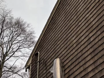

Ok, so all the pipe finally came in after almost 3 weeks. Everything looks to be in good shape and not damaged.
We finally had a day of warm weather so I finally got started. This is going to be a through wall installation using ventis pipe with a little under 3' vertical feet of double wall going up and out through the wall thimble. To get the stove perfectly centered, instead of centering the thimble exactly between two 16" on-center studs, I shifted it over about an inch or so and cut out my 12" x 12" hole. One thing I don't quite understand is that since you need to frame out a 12" x 12" box between the studs for the thimble to mount to, this puts the class A going through the wall closer then 2" to combustibles. My thought was that maybe the metal thimble itself provides a radiant barrier to allow for this?
This brings me the my first concern. The good new was that right in the middle of the wall is an outlet to provide power for the blowers. The bad new was that the power going to this outlet is routed inside the stud bay that I'm going through with the thimble. You can see this in the pictures I attached. I can't decided if this is something to worry about or not. It's no closer to the class A then the wood framing would be so maybe it's not an issue. Re-routing the would be difficult since it comes up from the basement and also feeds a couple rooms upstairs.
The second problem I ran into is that I purchased a 12" length of pipe for the horizontal run into the tee. This puts the exterior vertical part of the chimney about 2" away from the side of the house (cedar shingles) but when it gets up to the roof, it will pass by the rake boards, drip edge and shingles which protrude about 2 1/2" further then the siding. I see that ventis sells and recommends using a telescoping section to be used for this purpose or I could purchase the next longer length of pipe which is 18" but this would put the vertical pipe a little too far from the side of the house and possible outside the range of the wall supports.
I would really appreciate anyone's thoughts on these two issues. Hopefully I can get my hands on which ever pipe a little quicker so I don't have to wait another three weeks to finish this up.

Chip, leave the wire where its at. I would purchase a 10 ft legnth of 3/4 thin wall conduit, and find someone with a good band saw. Rip it in half and use one the pieces as a shied. you can secure it with one hole EMT straps. for got to mention, cut to legnth before you rip it
