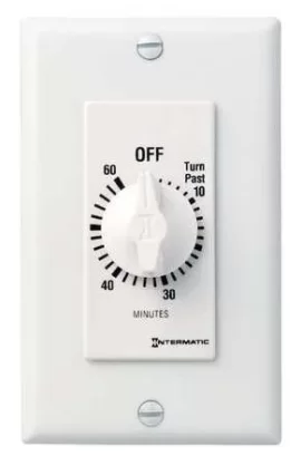

Spring Wound Timer. then you won't forget to turn it off...
  • [Hearth.com] Want to wire a simple on/off switch in addition to the thermostat, with LED indicators
