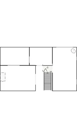

I created a floor plan drawing that shows the placement of my existing insert (c550) -- square on the LEFT. The stove I've been disussing in this thread and the room in question is in the room on the right. Any suggestions about how to get some of the heat from the converted garage, through the hallway and into the other areas would be great. Above the converted garage is a bedroom if floor louvers are a possibility.
Thanks.

The fan I mentioned above draws air in from the sides rather than the back. If you placed one of those just outside of the top-center room in your drawing, pointing toward the converted garage, it would draw cool air out of the non-heated room, direct it into the warm room, and possibly start some convection. The air pulled from the cool room has to be replaced by something, and the only thing available will be warm air near the ceiling. Worth a shot.
Since you already have an insert, you can see how well a fan will work if you fire up your insert and then set a fan a floor level, pointing toward the room with the insert. (I'd have it right at the doorway to the room with the insert.) This arrangement works well to move warm air from the great room in my house to the bedrooms. I also have a ceiling fan in the great room as well.
Thanks. I've never done much experimenting with air movement having resigned myself to limitations of a broken up floor plan. I'll put a fan on the floor in the living room blowing towards the insert and see if I can get any circulation.
