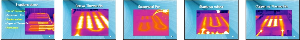

Conduction is the best transfer by far. The tube needs to touch the floor and aluminun really helps with the connection and spread. Here are some infrared pic I took when I researched the transfer difference.
You can see where I routered thru the aluminum on the Warmboard and how it stopped the heat transfer.

Unfortunately there is not a thermograph of a room side sleepered system, where the tubing is on the room side. With tubing 5.5" OC, I think the fins are a lot less important.
Tubing is inexpensive and the closer spacing will mitigate a lot of the need for aluminum.
The Warmfloor looks hotter because it is not conducting through a subfloor. The fins certainly help in the Warmboard case since it is 12"OC (I think?).
There has been a lot of work in Europe where tubing is 3" OC. The closer tubing is spaced, the higher the heat output and/or the lower the operating temps can be.
I am skeptical of the cost benefit of the Warmboard. We used a similar product for some TV programs where we did radiant systems. It was fun to use but I cannot cozy up to the cost, especially IF you want to do an inexpensive DIY system.
By all means Warmboard is nice stuff. I think all the competing products will perform similarly. I would shop price and Google for competing products.
