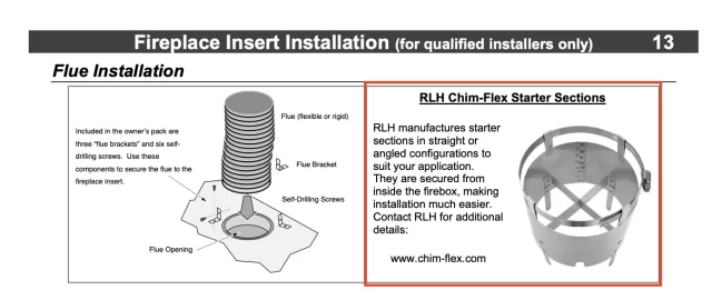

The best thing to do is to ask the company for more details on the installation of the large insert. The liner can be attached from the inside of the stove with the proper adapter. That would be my guess about their method. If they are using this method, as long as they have measured carefully and the top back of the insert doesn't hit the rear slope of the fireplace, then it should be ok.

Thanks for you're reply! Is that adapter to attach from the inside specific to Lopi, or is it universal for other inserts?
Also, is there any reason to be concerned with that type of installation -- connecting to the liner from the inside of the insert? Any safety or performance issues?
It's universal, but works better on some than on others depending on access from the interior of the stove. There are other solutions too but this one is suggested in the Lopi manual.
Done properly, it should function well. A bigger concern is the quality of the liner and whether it's insulated.
