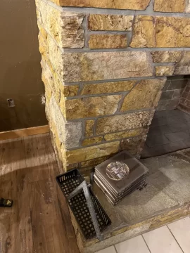

Hello all,
I am planning on getting a Lopi medium flush insert but had a couples questions about the power cord. I have an outlet outside of the fireplace that it is a few inches away from the back of the fireplace and it was what the previous owners used on their insert. However, the cord came out of the front of where the blower box was and this was in front of the surround.
So would the cord fit through the surround and is it okay to do this? Second, there is a high temperature power cord kit from Lopi that uses conduit to run in from inside the fireplace and cutting a hole through the fire place to get to an outlet? Is it okay to drill through the side of the fireplace to get to an outlet? I am okay with just running it through the front if that is doable, I am not super concerned about the aesthetics of the cord being visible. Just want to be safe and practical.
Thank you,
Bob

So there is a small wall, drywall, I assume they made it primarily for running electrical to it and the baseboards to the left of it. And I guess to make a a hallway barrier its only 4-5" wide. Directly behind it there is another outlet. But their is an outlet directly next to it as well, almost flush to the left. Also, I haven't purchased the insert yet. I am still trying to figure stuff out before making a decision.
View attachment 340692View attachment 340690
View attachment 340689View attachment 340691
You would need to talk to an electrician, but I would be looking at getting power from one of those plugs, then to a switch next to the fireplace (blower switch) then add a metal outlet in the very back of the fire box. I don't see how the fireplace in the next level down could be directly below? Investigate also what is included with that optional plug kit and price, in case you have to run it out to the front.

Yeah lol. I try to do things the right/safe way. This property has honestly been a headache dealing with, a lot of sketchy stuff the previous owners did. For good or probably mostly bad but I live in Montana and are outside the city limits, so we are under county jurisdiction and there are no building codes for the county. I also did start cleaning the liner but part of my cleaning brush fell from my off into the insert and I couldn’t get to it because of how the insert was setup. I actually posted about it on here and that’s how I found out how unsafe the insert setup we had was.
To the OP, my set up is real similar to what your planning to do. I have the Lopi medium flush. If you install it, I would route the power cord down low neatly tucked/clamped out the front and around the stone column to the outlet.
Great, that’s what I was planning on now. How do you like the lopi? It’s going to be in our main living room and hoping it doesn’t get to hot.
