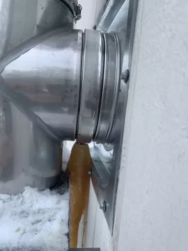

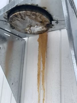

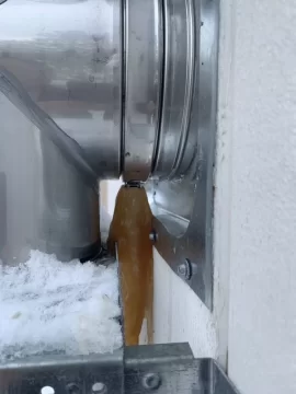

Doesn't look normal to meIs this normal? I am a bit concerned that maybe when the stove is not in use, I ma getting snow water via the cap? Don’t know....
@bholler any thoughts?
View attachment 257143View attachment 257142View attachment 257141
Is it possible, that rain water or snow is getting via cap? My wood is well seasoned. Don’t believe this would be condensation....
Yes, when cold quite bit hanging off the cap. Like two days ago!On your VC or BK? Any of that hanging off the cap?
This is the last thing I want hear. Thank you however. Do not have that issue with the VC (had to put this out there).Your chimney is cold and your steamy flue gasses are condensing and running down. You’re lucky that the water has a place to go other than in a puddle inside your home.
Running hotter flue gas temperatures would solve this. Just because the BK can run so low that it becomes a condensing appliance doesn’t mean you should. A second option would be an insulated chase around the pipe.
I don’t suppose you’re interested in converting to an all vertical interior chimney system.
I would be awfully tempted to poke a 1/4”’hole in the bottom cap of the clean out tee. Keep it clear to allow drainage.
What would that do? Condensation would just drip back into the stove lowering the flue temp and creating more creo? I am sure I am not the first one with this predicament.I don’t suppose you’re interested in converting to an all vertical interior chimney.
Running the chimney straight up thru the interior of the house will keep the flue gases much warmer, thus avoiding the condensation. That will also help the flue stay cleaner and it will improve draft.What would that do? Condensation would just drip back into the stove lowering the flue temp and creating more creo? I am sure I am not the first one with this predicament.
