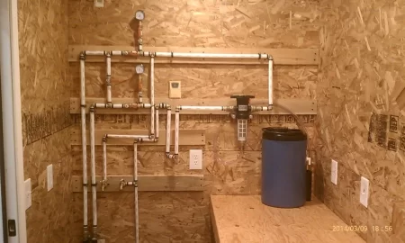

I had a fun sunday setting up my home water treatment. Just need to set the iron filter now. It is basicly a softener with different media and a chlorine backwash instead of salt.
Raw comes in on the left, raw and treated pressure gauges, raw and treated hose bibs, bypass valving, and a 60 mesh grit filter prior to the filter. I plan on using stainless steel corrugated flex lines for the actual filter hookup. The 2" drain line on the right goes to a trap and then to the downspouts.

HighBeam.....are you running anything besides the Fe and mesh filters? (softener, e.g.). If so; what is the layout? (I know it should be iron first, but want to hear from some real world experience.)
I tested my well's water and had good ph, low hardness, some iron, and a light musty smell. I dont need a softener but i do need to get that iron out which will also strip the smell. If i were to add a softener, it would go after the iron filter. A softener could probably take care of my iron level but the smell could be sulfur or iron bacteria which are not good for softeners. My hardness level was only 16 ppm which is less than one grain. A lot of this is educated guessing. Ideally, and at work, ee would set up a small scale pilot test.

Nice job. I like the PEX.
Are you using the copper rings or the stainless pinch clamps? I can't tell from the photo.
Copper rings, almost 70 on that wall. 100% success with them so far.
