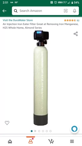

Ok to the op we had similar water problems in our house. When we moved in there was a softener system with pre and post filters that worked ok but was a pain. I swapped it out for an air injection filter system with pre and post filter. It works far better with very little maintenance. The pre filter gets changed once every 2 months because we have allot of particulate and the post filter every 6 months. Otherwise it backflushes itself. They say the filter media will need changed between 5 and 10 years depending upon the level of iron we have. Ours will probably be closer to 5.
This is what we used had it speced out by my buddy who is an engineer who designs lots of water systems
Nice system. Basically what I have. The pre filter makes sense but what does the post filter do? The iron filter is an excellent filter itself with a very low micron rating.
Reactions: bholler
Some of the manganese gets through because it takes a little longer to oxidize so it can be filtered out after air exposure. I don't really need it the levels aren't high enough to effect taste or safety but we would get staining.
Edit now that I am thinking about it I think it wasn't the manganese it was a little ferrous or ferric iron. But I can't remember. I will see him this weekend and ask him. I know that filter is really fine and what it's filtering out is black
If you’re getting break through, where some iron or manganese makes it past the filter, that usually means it is undersized. A bigger iron filter of this type means the water will pass through more slowly and have time to convert to a solid and be caught. A second filter won’t hurt though and should not need service.
Can you share what pre & post filters you are using. I have a simple 4x10 aqua pure whole house canister filter, but I don't drink the water. I have been wanting to get a set up like you described, and now that thew mortgage is paid off, I can afford it. But will be a DIY and not looking to spend thousands. Looks like that one is a decent procduct at a decent price. Thanks
Just a 50 micron before and 5 micron after. I should have put a larger prefilter in though
How much water does that iron eater system backwash at night?
I honestly have no idea on volume. It backflushes for 15 mins I believe
Usually at high gpm. Think 10 gpm. So you’re dumping 150 gallons each time plus a rinse of several minutes. The theory is that well water is essentially free so it’s okay to dump. I dislike wasting the water so I stretch my backwash cycles to weekly but some systems don’t allow that.
Mine is every 3 days I tried stretching it out further but it didn't work
