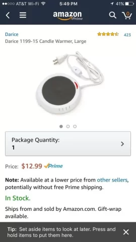

I bought the wife a candle warmer, best 13 bucks ever spent. She used to leave candles burning all the time, always scared she would burn the house down.
[Hearth.com] Wax on stove
I think there might be a better chance of that Chinese made warmer burning down the house! ( I have opened up a bunch of Chinese electronics and have found many times the ground is cut and not even connected inside the unit!! Also have seen neutral wires as the switch instead of the hot. Scary stuff)
