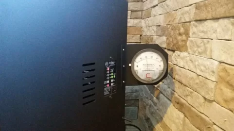

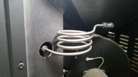

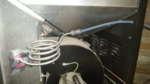

Well I got my mag today and started the install, heres a few teaser pics I still need to make the bracket to hold the gauge. I drilled and tapped the side of the fire box which I think will give the most accurate reading. I know the coil is probably over kill but I would hate for the teflon tube to melt and its just stuff I had laying around, more pics to come...

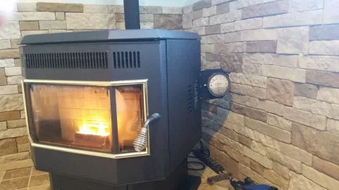

Finshed product now just time to tinker and get the best burn and heat output

well it seems that i am getting my best burn and heat output and its pulling right at .15", drops down to around .12" on low heat. its kinda cool how the reading changes as the burn pot gets dirty, i think it will be a nice tool to keep the stove running the best it can, and hey gauges are cool!
