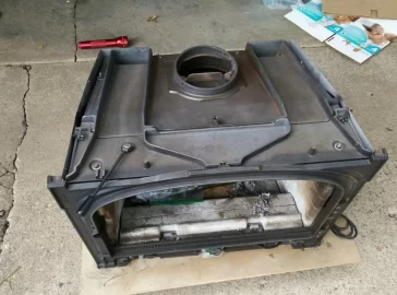

How and where are you measuring stove top temps on the insert?
IR gun into the air channel. If I aim it just right I can hit part of the stove top that goes up as a lip or sidewall to the air channel. This lip is part of the stove top.
I'll post a pic later of the Montpelier to show what I mean. I've run it with the surround off too and measured stove top directly (there is a portion around flue collar where the stove top is exposed and not covered by the convective jacket.)
If you look at the parts diagram in the Montpelier manual it will make sense. Kind of a different design than any other insert I've seen.
Here's what it looks like with the sheet metal convective jacket off. Note I didn't even repaint the top, just the front really.
So I can hit with the lip with the IR gun easiest on the right side..the left side is hard due to the air slider.

Btw what you see in the pic above is after repainting. so almost no paint on the top. Also, just FYI the sheet metal top is kind of U shaped, it sits over the air channels on the left and right but does not cover that middle section where the flue collar is.
Oops just looked at the pic again, it's not after repaint but my new paint lines are about the same as the old. Just a few inches up onto the front of the top

The reason I asked is that the temps you are reading may be on the low side. Closer to the flue collar the stove may be getting much hotter. What you are describing sounds like that hot metal smell that often precedes or accompanies overfiring. If it happens again and it is night, turn out the lights and look through the vent toward the flue collar. If it is glowing dully then the stove is too hot.
I'm going to pull the surround before my next test burn and check temps at all areas of the stove top and also the external liner temps. Hopefully that might shed some light on things.

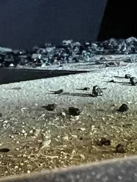

Our Vermont Castings Montpelier also off-gases when running hot. Based on this thread the smell could be from the cast iron stove body, sheet metal surround, or the rockwool insulation. But i've discovered creosote particles have fallen down onto stove top so I'm going to remove those and hopefully that helps.

I’m guessing the creosote bits in that last picture you put up is probably what’s causing the smell. Maybe it’s a matter of a certain temperature needed to cause the offgassing of those little bits.
How did creosote form outside your stove pipe?
Was the chimney not cleaned before the insert was installed?
This house was built in 1960. Previous owner had a large, mid-1980s wood burning stove using this chimney. Prior to purchasing the home in 2017 a very expensive chimney inspection found cracks in the tile. My recollection is we decided not to pay them to clean an unusable clay-tiled flue. Instead run an insulated 6" flue to a new insert. Having said that, my wife thought we had it cleaned. If they did clean it, they didn't do a very good job. Anyway, not a big deal to pull the insert forward 6"and vacuum the creosote particles. The insulated duct likely moves a little when i clean it each spring, causing little pieces to fall.
You would need the chimney cleaned prior to installing the insert. A hot liner could potentially ignite buildup causing a big problem
And smell from pieces of creosote falling every year down on top of it!
I’m surprised an installer wouldn’t mention that. It seems like they’d get lots of calls for smells as you’ve had or even a chimney fire calling unwanted attention to their work!
Maybe call the installer and demand they rectify.
