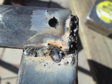

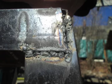

Ok, the project is mostly done. I rented the Lincoln MIG from HD. Someone please tell me where I went wrong on the welds. I had visions of nice, cleaner looking ones. The auto feed was intially set too high and the flux core wire was be-boppin' all over the place. I squared that away, increased the power output a little higher. Maybe I did not go high enough or was the weld to slow? I flap sanded all the joints to bare metal before giving it hell-o. I found that black iron pipe does not weld that well to a floor flange. Never mind welding that to the brake drum. I would assume it was cast iron as most of the reason. I give credit to anyone who can run a nice weld btw.
Looks like weld puke.

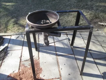

I made a plywood jig with 8 degree cuts to flare the legs out on the sides for stability.
[Hearth.com] Welding Newbie.  Mig or stick?
The frame was made from a discarded bed frame angle pieces. It is very stable, but when I locate some more, I'll add bracing and a shelf.
Looks like you could use a tad more heat and work on moving the gun in a weave or lowercase "e" type pattern.
Wirebrush & hammer the welds to chip any slag that's stuck on them.
Reactions: fishingpol
A touch more heat and you were holding the handle wrong. It appears that you were pointing it straight at the joint (weld). A mig should be "pushed into" the work.
Edit: I am not a big fan of flux core welding. If you are gonna use flux, use a stick welder. Gas shield welding is where the migs really shine.

looks like not enough heat and the nozzle was being pushed too far away from the puddle, MIG works by melting the wire and the steel inside an envelope of inert gas (usually argon or a mix of argon and another inert gas) if the nozzle is too far away from the point of the joint to be welded if the puddle gets outside of the pocket of gas the weld bead becomes loaded with air bubbles.
as for direction when the weld is being applied horizontally (flat welding), the puddle is "pushed" by the wire, when welding vertically, the puddle is pulled downhill. an inexperienced welder would likely fare better with flat welding as they wouldnt have to "keep up" with the puddle
