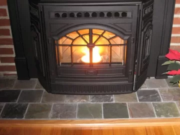

Woke this morning and stove was off, started to freak out. After you read these forum enough you think the worst case scenario.
Well I ran out of pellets, can't believe that I forgot to fill the hopper before I went to bed. Loaded it it up again this morning and she started to work and then died out.
Did not have time to fuss with it because we got snow and wanted to ride my sled.
So came home did a good cleaning and pressed reset button to make sure it would load burn pot!
Good to go! man I was freaking out because it has been so toasty in the house.
