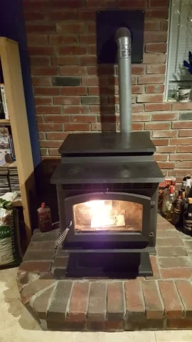

Sorry for so many updates everyone. I'm a dummy! Cleaned the stove and was getting the #2 flash. Put the plate inside the firebox to close up the opening below the pellet firebox grate and turned the stove on and it worked just fine. everything is working now!

Blower must have been really dirty. took it apart and vacuumed a lot of thick dust bunnies from it. put back together and started right up.
Will hook it up to piping this weekend and post final pics of it running.
Not bad seeing I bought this for $150 because the owner did not know if it ran in the house they just bought :).
