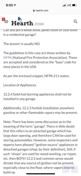

Talk to my agent again this morning and he assured me that I am allowed to have a wood stove in my garage as along as it’s professionally installed
I showed him this pic and he assured me I could do it
Make sure that is in writing. Because it is without question against code. Your agent is simply a salesman.
