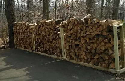

Finished stacking the first cord yesterday, which has been tough to do after work since my stack area is not well-lit. Today we're getting wind gusts up to 60 MPH and the smell coming off the pile is AMAZING.
[Hearth.com] What am I in for?
This is what the guy sold me as "one cord." I'm estimating the stack is about 5 x 24 x 1.25, plus a little extra stacked behind the oak tree in the left of the photo.

A cord is 128 cubic ft. Those dimensions are 150 cubic ft. Looks like you came out ahead for one cord.
Use this site to calculate what you have.
http://www.maine.gov/ag/firewood.html
