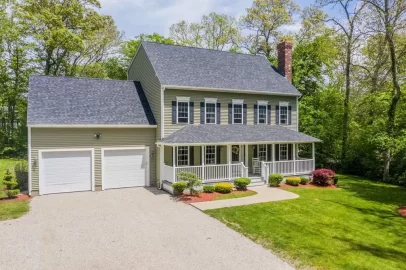

Hi I just bought a comfortbilt hp22i insert and going be installing it this wk. Its going on 1st floor home has 3 floors not counting basement. House is a 3 floorcolonial. My house is a single family 3600 sqft home with hydro hvac system and oil bill is huge so trying help it out. Just wondering what I can do to try get most out of pellet stove so I don't need as much oil . I know pellets ain't cheap so not sure whats the better heat source.

Heat rises, it don't fall...lol Your basement will stay cold no matter how warm the upper floors are, fact of convection. Add a couple fans to move the heat around but don't expect a 50K max input pellet unit to heat your home to a sustainable comfortable level because it won't. Multiple units might, but one unit, NO WAY, no matter how balls out you run it.
I use 50K BTU as my benchmark, yours may, in fact, be less and that is 50K input, not output. Typically biomass stoves are around 85% efficient, so that 50K drops to 42,5K 'actual heat output. Much, much less than your central heat plant output.
Biomasss stoves are SPACE HEATERS and will never replace a central heat plant, they will only lessen the heat load, nothing more.
Again, expecting ANY biomass stove to completely offset a central heat plant will result in disappointment for you.

I would imagine a house like that is quite compartmentalized. Lots of individual rooms on different floors. One stove won’t do it. One stove on each floor might but the rooms will never heat evenly. But as posted you’ll be going through a lot of pellets. And hauling them too. My stove is right at the entry door which makes it easier.

It would be more useful to see the floor plan than the outside of the house.
If you have it in a room with an open stairwell, then much of your heat will climb the stairs, which can help warm the rooms up there, but will make it a challenge to keep the 1st floor rooms warm.
If it's not in a room with an open stairwell, it will make that room hot, and other connected rooms will be slightly warmer than if you didn't have the stove.
