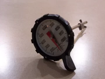

Heard they were good.It will be on my vertical pipe about 3 ft from stove.Do i just drill horizontally into my double wall or should i angle it slightly so as not to fall out.Don't want that glowing thing fallin on the floor.Also what temps should i look for?I have read other posted reviews but everybody has a diff setup etc.3/16 through double and1/4 through outside i hear.
I like the SBI probe, it's similar to the Condar but has black and silver zones. Drill it straight horizontal, they have a magnet to hold it there. Instructions should be on the package.

+1 instructions on the package, but yes, I think I went up 18" (whatever the package said) and yes 2 bit sizes. The inner and outer pipe will expand and contract at different rates.

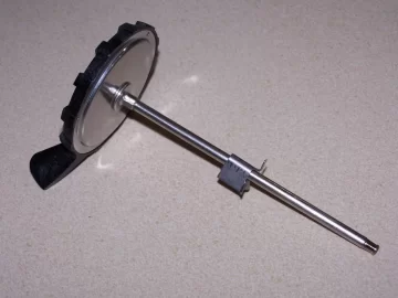

I like the Temp Point. Can be calibrated and comes with it's own mounting clip, so it doesn't [Hearth.com] What brand flu thermometer[Hearth.com] What brand flu thermometer[Hearth.com] What brand flu thermometer turn or sag. Easy to see at a quick glance.

Happy with my Condar probe thermo . . . straight drill . . . you will need two different size bits. There is a magnet . . . I have yet to hear of anyone who has had one of these fall out of the flue. My normal range temp is 400-900 degrees F.

I got the SBI probe also because of the black and silver face. Very happy with it and I am pretty sure it is made by Condar.

But on double wall (why you need a probe). The pipe doesn't see the very high external temps. That and there is a probe stuck through the hole. So it takes very little magnetism to keep it there.
