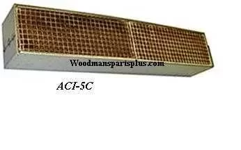

This is a guess of what might fit, but be sure to double check measurements and confirm which dimension they mean by width vs depth or height.

i think that will definitely work. Is there a particular reason why i should go with a canned combustor? It looks like the gasket material on there uncanned combustor expands and could quite possible fill the void
That's a good question which I am not sure about and don't want to mislead you. I thought the uncanned combustors had a specific, tight receptacle for the catalyst, but could be wrong. Ask whether it needs a gasket kit too. I think that you will need the gasket and the canned unit, but am not sure. When you call around for your unit, ask and let us know what you find out.
Also found this via Google for the same part, though I have no prior knowledge of this site or Firecat combustors, but the pricing is good and includes the gasket kit.
(broken link removed to http://firecatcombustors.com/Catalog/cat-Webco.htm)
FYI, your stove's cat size is similar to the Earthstove 1003-C - (broken link removed to http://firecatcombustors.com/Catalog/cat-Webco.htm)
